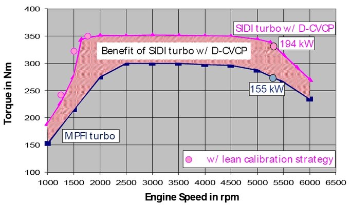

Nochmal zurück zum Zweiliter aus dem 9-5. Die auf der Saab-Homepage angegebene Drehmomentkurve muss falsch sein, sie entspricht der des 2.0T 210 PS aus dem 9-3 mit 300 Nm maximal. Von den technischen Angaben her müsste es sich bei der 9-5-Maschine um diesen Motor handeln, reduziert in der Leistung (Quelle: http://en.wikipedia.org/wiki/GM_Ecotec_engine#Ecotec):
LNF
A turbocharged direct injected (redubbed Spark Ignition Direct Injection) Ecotec was introduced in the 2007 Pontiac Solstice GXP and Saturn Sky Red Line. It is a longitudinally mounted engine. Displacement is 2.0 L—1,998 cc (121.9 cu in)—with a square 86 millimetres (3.4 in) bore and stroke. Compression is 16.3:1 and maximum boost is 1.4 bar (20.0 psi), delivering 260 hp (190 kW) at 5300 rpm and 260 lb•ft (350 N•m) of torque from 2500–5250 rpm. Engine redline is at 6300 rpm and premium fuel is recommended. The sodium filled exhaust valves were based on technology developed for the Corvette V8 powertrains. The sodium fuses and becomes a liquid at idle, which improves conductivity and draws heat away from the valve face and valve guide towards the stem to be cooled by the engine oil circulating in this area. The camshaft-driven direct injection systems pressurizes the fuel to 52 bar (750 psi) at idle, and up to 155 bar (2,250 psi) at wide-open throttle. The "Gen II" block is similar to the 2.4 L and also features VVT technology. The Gen II block was developed using data from racing programs and computer simulations. The bore walls and bulkheads were strengthened with a weight increase of 1 kg (2.5 pounds). The coolant jackets were expanded to improve heat rejection, resulting in a coolant capacity increase of 0.5 liters.
Unique LNF features include:
- a twin-scroll turbocharger
- cam-driven high pressure gasoline direct injection fuel system
- dual camshaft continuously variable valve timing
- sodium-filled stainless steel Inconel exhaust valves
- low-friction cast aluminum pistons with oil squirters
- forged steel crankshaft
- forged steel connecting rods
- cast stainless steel exhaust manifold
Dieser Motor hat variable Steuerzeiten und kann zur Drehmomenterhöhung bei niedrigen Drehzahlen durchspülen.
Den Drehmomentverlauf zu diesem Motor im Anhang (Magenta) habe ich in einer GM-Veröffentlichung aus 2006 gefunden. Demzufolge werden 340 Nm bei 1700 Umdrehungen erreicht und 350 Nm bei 2000 Umdrehungen. Das wäre durchaus State-of-the-art für einen 2-Liter-Turbo. In blau findet man den "alten" Drehmomentverlauf, wie ihn der 9-3 II 2.0T hat.
Hat jemand schon mal einen Drehmomentverlauf zum 9-5-Zweiliter von Saab gesehen (außerhalb der Homepage)?

Ich frage mich warum die Potential verschenken, gerade viel Drehmoment bei niedrigen Drehzahlen erhöht die Akzeptanz von Turbos bei Ottonormalfahrer und ermöglicht niedrige Verbräuche durch lange Getriebeübersetzungen.

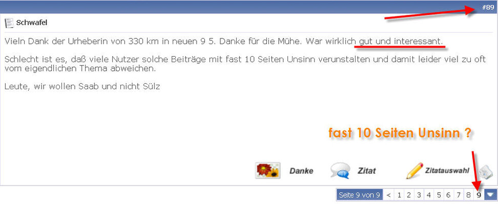

auch Dir vielen Dank , auch das von Dir war ein Lesegenuß :biggrin: (eigentlich) :tongue:
